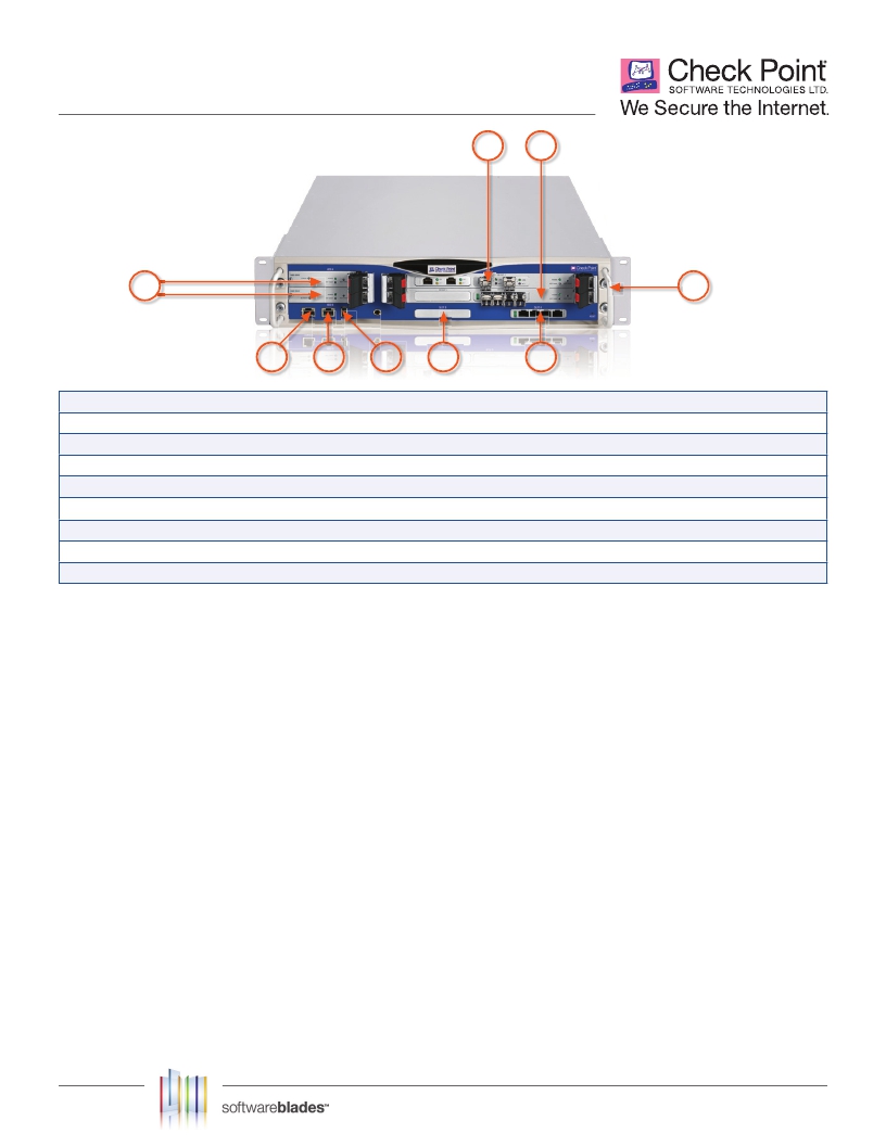

Check
Point
Factsheet:
IP
Appliance—Model
IP1287
1
7
8
9
2
3
4
5
6
1.
Optional
redundant
hard
disk
drives
w/carriers
2.
Console
port
3.
Auxiliary
port
4.
USB
port
5.
PMC
expansion
slot
for
optional
PMC
or
XMC
network
interface
cards
6.
Management
and
sync
ports
7.
Optional
PMC/XMC
network
interface
cards
(6U
carrier
is
needed)
or
ADP
module
(comes
with
carrier)
8.
Optional
PMC/XMC
network
interface
cards
(6U
carrier
is
needed)
or
ADP
module
(comes
with
carrier)
9.
Slide-out
chassis
tray
