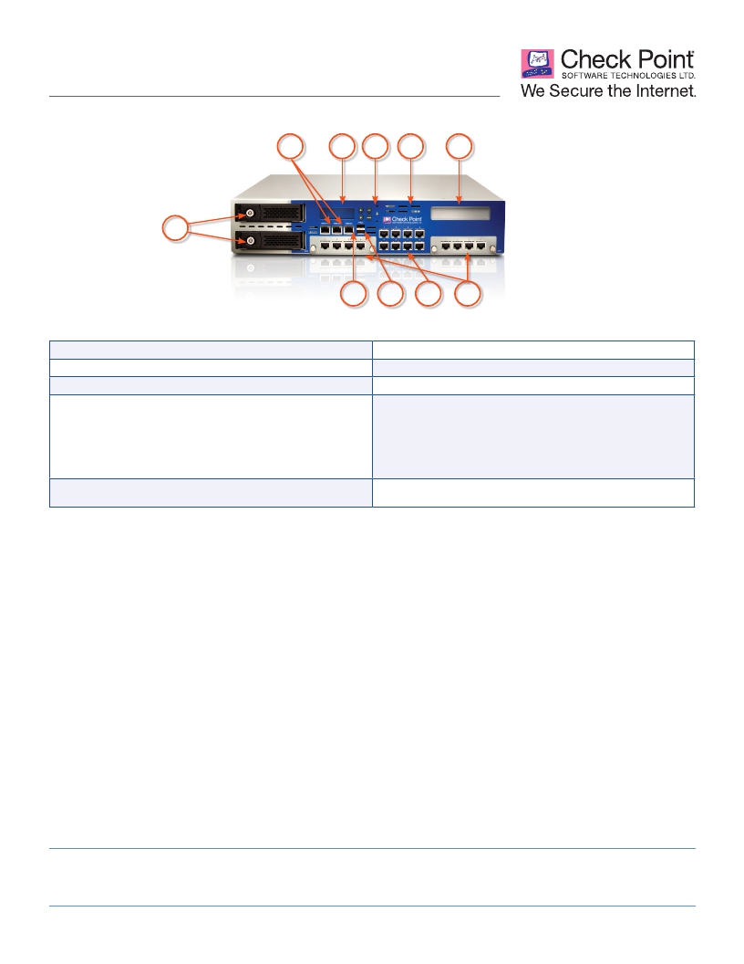

Check
Point
Factsheet:
Power-1
Appliance Model
9077
5
2
3
4
10
1
6
7
8
9
1.
Redundant
Hot-Swappable
Hard
Drives
2.
LCD
Display
3.
LCD
Control
Buttons
6.
Console
Port
7.
USB
Ports
8.
8
x
1GbE
Ports
4.
Air
Intake
5.
Management
Sync
Ports
9.
10.
Field
Swappable
Expansion
Modules
(Basic
configuration
includes
4
1GbE
Ports
Module)
1
Gbe
Copper
(4
Ports)
1
GbE
SX
Fiber
(Multi
Mode)
(4
Ports)
1
GbE
LX
Fiber
(Single
Multi
Mode)
(4
Ports)
10
GbE
SR
Fiber
(Multi
Mode)
(2
Ports)
10
GbE
LR
Fiber
(Single
Mode)
(2
Ports)
Lights-Out
Management
Module
(Optional
Out-Of-Band
Management)
