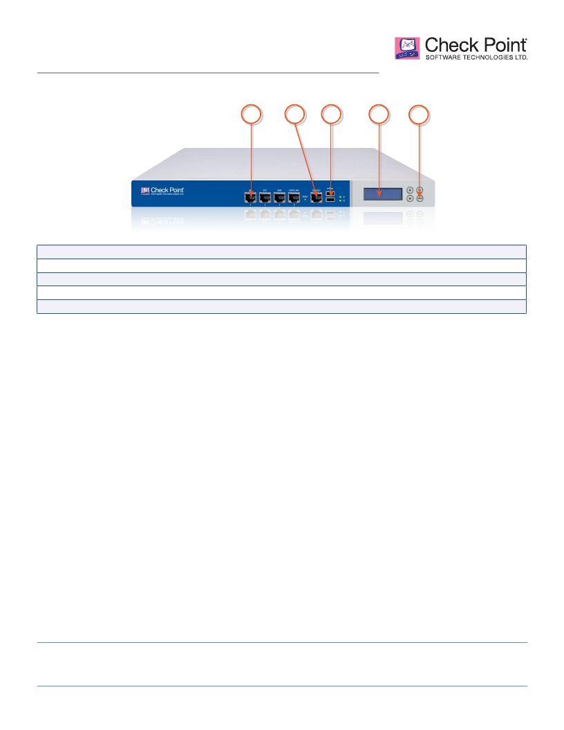

UTM-1
Appliance Model
278
1
2
3
4
5
1.
4
x
10/100/1000
Ports
2.
Console
Port
3.
USB
Ports
4.
LCD
Panel
5.
LCD
Panel
Controls
